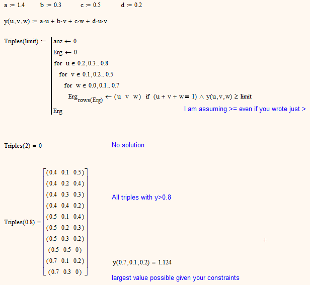

Hi, I am quite new to mathcad and need help with the following problem:
a*u+b*v-c*w+d*uv = y
a=1.4
b=0.3
c=0.5
d=0.2
u, v, w are variables that fulfill some constraints:
0.2<u<0.8
0.1<v<0.5
0<w<0.7
and
u+v+w=1
and
u, v, w can only have values like u = 0.2, 0.3, 0.4, ... but not 0.25 or 0.21. (I am sure there is a mathematical term for numbers as such, sorry)
Now, I want mathcad to give me all possible solutions (all different compositions of u, v, w) that fulfill y > 2.
Thanks for any help.
Max
Best answer by Werner_E
Here you are, but with more variables and maybe a wider range a brute force approach can be a problem - at least with respect to calculation time.
As you didn't specify the datastructure of your results I chose a nested vector. Each vector element is a 1x3 matrix consisting of the three values for u, v and w.
BTW, the testproblem you had set up has no solution as you can see here:

d*uv should be d*u*v ???
November 19, 2013
yes, not a differentiation
November 19, 2013
ehh, deduction
