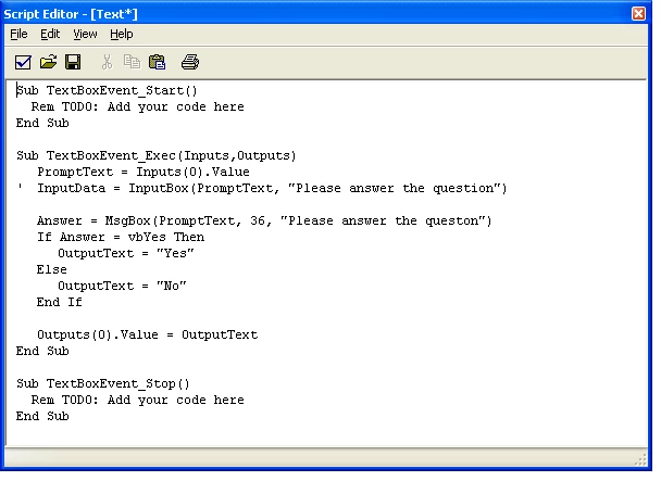

In my calculations at a certain time occurs a pop-up window with a specific question:
Is it possible to create a pop-up window like the following type (answer "Yes" must return "1" and "No" return "0" into variable "Question")?

Thank you, Richard!
So the script code should look like this:
March 2, 2013
Yes. The key points are that the MsgBox must be called as a function, with the arguments in parentheses, so that it can return a value, and that magic number, "36". The number determines the appearance of the MsgBox, in this case with "Yes" and "No" buttons, and a question mark icon.
