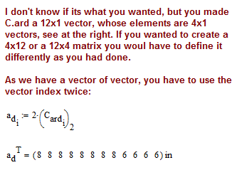

In the attached MathCAD 14 worksheet I'm attempting to create a new vector that is 2 times a particular value within another vector. More specifically, I'd like the (12 position) vector a.d to be 2 multiplied by the second value in all 12 C.ard vectors. How to tell a.d to successively address the second value in each C.ard vector and multiply it by 2?
Best answer by Werner_E
Like so?
Werner_E25-Diamond IAnswer
June 7, 2013
Like so?
dsochor1-VisitorAuthor
June 12, 2013
Thanks again Werner, your vector of a vector notation is exactly what I was looking for.
