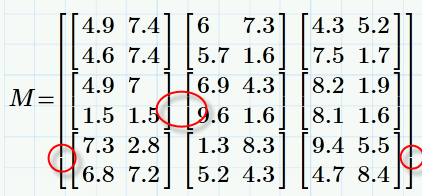

2) Why are the matrix/vector [ ] or ( ) not continuous ? (try a 3x3 matrix with 2x2 matrix element ... it is hard to see the elements)
