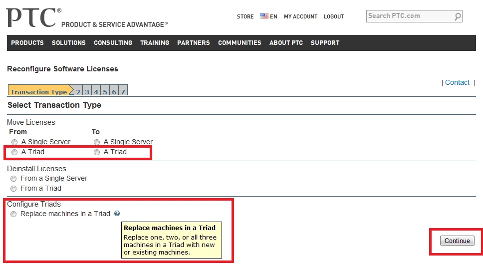

I've just moved our MATHCAD licensing to a Triad model as i'm decomissioning our old license server. But when I configure Prime to look at a license server it only appears to support one server.
I may be missing something obvious here, but does Prime not support Triad licensing? Despite you guys offering this?
Cheers,
Rich

Have you checked the following options when you reconfigure the license?
April 2, 2014

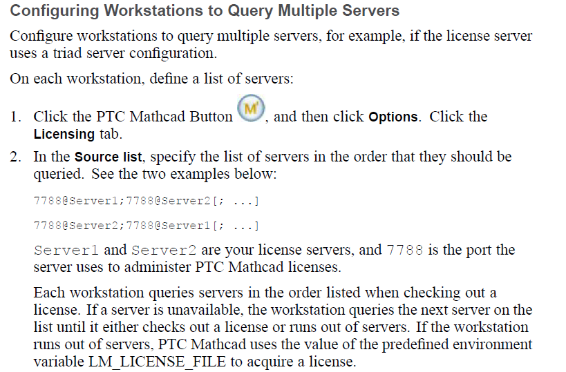

Yes - I have the triad and and running succesfully.
But i'm having problems getting Prime to actually recognise it's getting its license from a Triad - it will only let me define 1 server! When I put three servers in like so; @GBVUAP67;@GBVUAP68;@GBVUAP69 the software crashes.
April 2, 2014

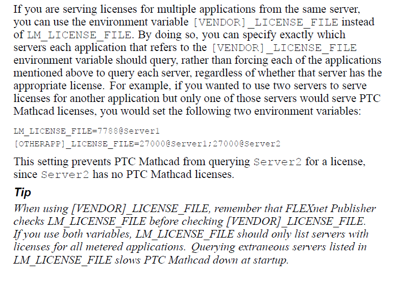

I think, it should be 7788@server1;7788@server2;7788@server3
You should enter it in the source list text box on Mathcad options window. See installation guide...
