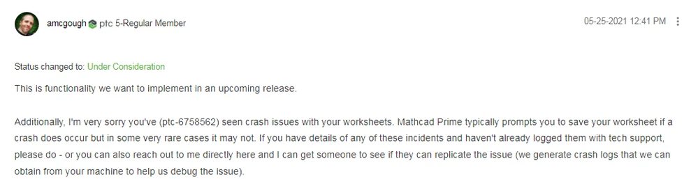

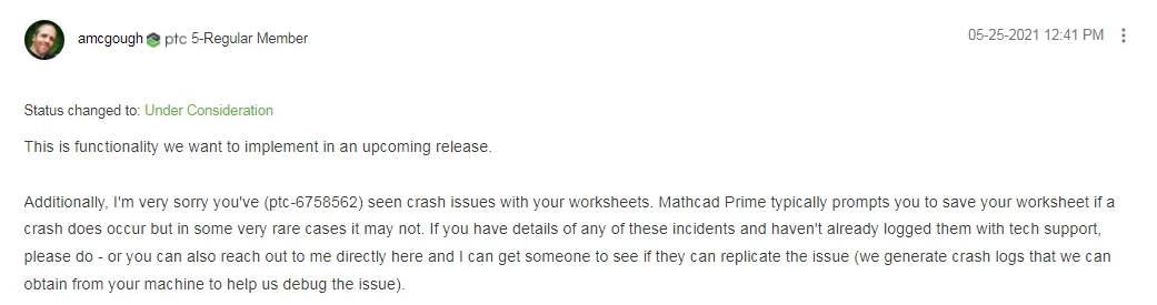

You can vote for this idea - "Autosave Functionnality in Mathcad Prime": https://community.ptc.com/t5/PTC-Mathcad-Ideas/Autosave-Functionnality-in-Mathcad-Prime/idi-p/653847
And a comment to it:
8-Gravel
December 17, 2021
The most recent event was when my system shut down unannounced, all work was lost, except those programs which create periodic backups.  Prime 7 was unfortunately not one of the programs which created a *.bak file etc. Please direct me to the crash log if it will aid in this endeavor.  I did re-create all of the lost work, but it cost me valuable time.
