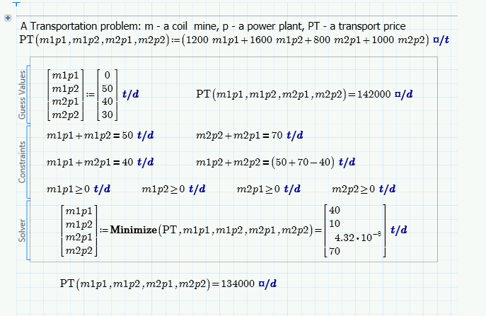

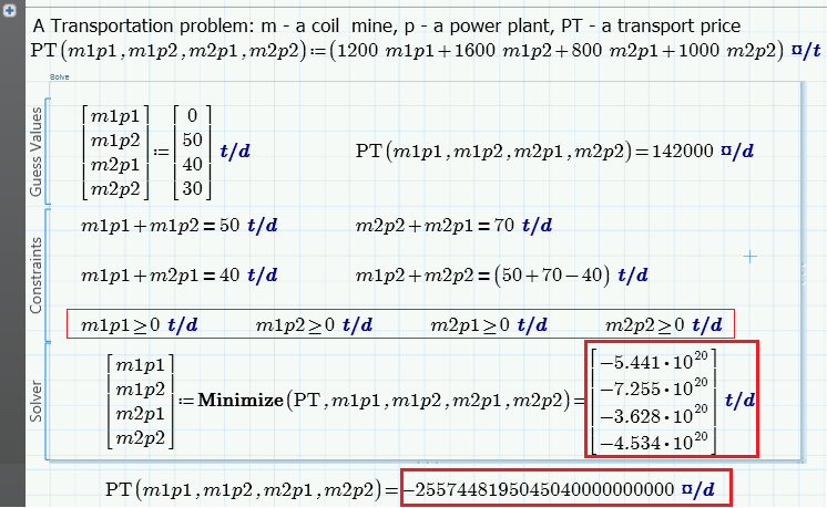

Prime (with me) cannot solve a transportation problem
  • November 10, 2012
  • 3346 views
Or new solver of Mathcad Prime is not correct or I do something wrong!
See the picture and the sheet in attach!
In Mathcad 15 all was OK!
About this transportation problem see here.

All I did was to click Calculate in the Calculation menu! Prime is weird!!

ALAN STEVENS wrote:
... Prime is weird!!
Alan
Prime must have taken exception to this comment as it subsequently refused to work! I had to reboot my PC to get it working again. What did you put in that transport worksheet Valery?!!!!
