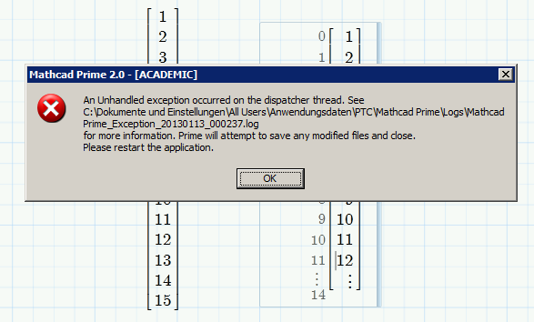

I came across that error while working on a worksheet in another thread here.
I do not have that much experience an I coul not find a way to look at the elements of a vector or matrix which are not displayed (that is more than the first eleven). I am missing the scrollbar and a way to resize that region.
When I try to go from one value to the next with the Tabulator key, whenever I try to go beyond the eleventh value I get an exception error.
Is it a Prime error or is my installation faulty?
Windows XP SP3, 1GB RAM 😞
Excerpt of the log file:
Exception data:
System.Object:
System.ArgumentException: There must be exactly rows x cols (15) but there were 12
at Ptc.Matrices.MatrixHelper.AddRow[T](Int32 rowToAdd, Int32 rows, Int32 cols, T[] elements, DelegateFunction0`1 createDefaultElement)
at Ptc.EquationEditor.Equation.EquationModel.ae.a(Direction A_0, Boolean A_1)

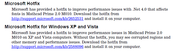

Have you installed .NET Framework 4.0 and some Hotfix's from Microsoft?
http://communities.ptc.com/servlet/JiveServlet/showImage/2-190370-38686/Pic_5.png
http://support.microsoft.com/kb/2652531
http://support.microsoft.com/kb/2588096

Vladimir, thanks for your reply.
.NET4 ist installed, otherwise Prime would not work at all, I think.
I have seen those two hotfixes mentioned in the past and decided to not install, as it didn't look like I have the problems described and M$ advises to install them not by default but only if needed(?) . Maybe I give them a try after the next complete system backup.

OK, I just tried it on two more computers. One of them XP, 32bit, the other Windows 7 and Prime2 64 bit.
On both machines I experience the same error!!
When I click in the second region (the evaluation of v, not the assignment) on any number in the vector and press the tabualtor key after element nr. 11 (12), Mathcad crashes and I get that exception error.
Three different macchines, Win XP and Win7, 32bit and 64 bit - so I suppose it to be a Prime2 error/bug.

Re-created the file & tried on Windows 7.
Tabbing down 1st column - reach the end & adds new elements at the bottom (OK assignment)
Tabbing down the 2nd column - reach the end & add new elements but greys the column (Wrong? - should be the display of a vector )
note that deselecting this column allows self-correction.
Tabbing down 3rd column - reach the last displayed element then one more tab will cause the crash
(note that it can take some time - so it is possible to think that later action could also have caused the crash).
So its a bug - thanks for verifying!
Thats exactly the behaviour I I experienced.
The crash only occurs when the region is sized so that not all elements of the vector are seen.
Someone from PTC should log that bug.
Another question: I finally found the way to resize the region, but what if the vector has, lets say, 2000 elements and I would like to look at the last ones? Resizing for the whole vector to be visible would be not practical and it seems to me that the necessary scrollbars are missing.

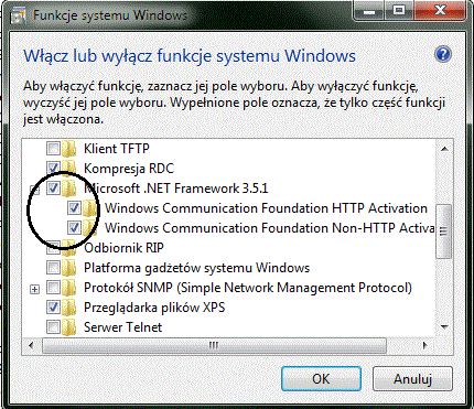

Jan, what do these two services of .NET 3.5.1 are for and in what way could they affect a .NET4 application?
I just activated both , but Prime2 stills crashes in the aforementioned situation.
It really seems to be a bug in Prime. If a vector region is sized so that only part of the vector is seen, mathcad complains (according to the log) that the vector has less elements than it should - one part of mathcad is aware of the elements not visible on screen, one other part of it is (wrongly) not aware of the invisible elements.
Obviously we are not supposed to tab through the evaluation of a vector, that approach is meant for vector assignments (and BTW is a nice feature). Nevertheless the program crash should not happen.
