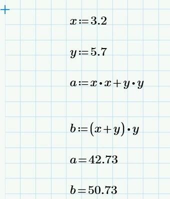

As an example: The writer is:
#include <iostream>
#include "PrimeWriter.h"
using namespace PrimeWriter;
int main()
try {
Worksheet ws;
ws.Define(L"x", 3.2);
ws.Define(L"y", 5.7);
Expr x = Id(L"x");
Expr y = Id(L"y");
ws.Define(L"a", x * x + y * y);
ws.Define(L"b", Paren(x + y) * y);
ws.Evaluate(L"a");
ws.Evaluate(L"b");
Set up the namespace
declare a instance "ws" of main Worksheet class
In this example define four things: numeric values for Prime variables x and y, two expressions a and b using Prime variables x and y.
Two evaluation regions for a and b to get the results.  It is these evaluation regions that are read by the reader.  Reader and Writer are two separate entities and no memory is exchanged between the two it is all through the hidden to the user XML.  You cannot yet create an inline evaluation expression in PrimeConnect, but you can read them.
This bit of code produces the following Prime worksheet.  The values of x and y are invisible to the C++ reader because they do not have evaluation equal regions in the worksheet.

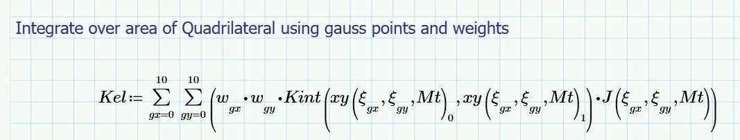

The "ws" syntax is simple to get to know and can build expressive mathematics, for instance:
