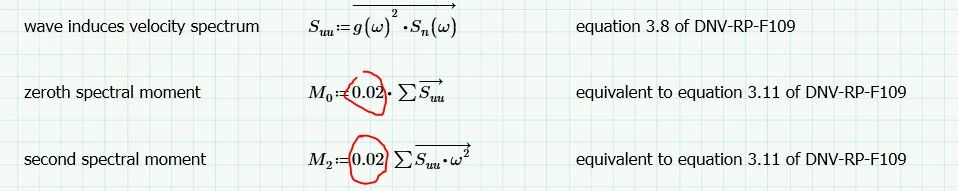

Jul 16, 2018 9:50 AM UTC
Hi Smungar,
Great job with this calculation. I guess topic is concluded but since I'm working with something simillar at the moment I made small notice.
One thing, might be me but I think this should state 0.01 instead of 0.02. h=(b-a)/n  --> (5,74-0,1)/283=0.02
I guess idea after this is to use approximation of trapezoidal rule,
 Regards
Jul 16, 2018 1:33 PM UTC
Now when I see it, complete equation looks wrong. Not sure which rule you used here, this is not Trapezoidal nor the Simpson's.
