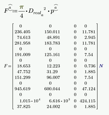

The cleaning function won't help anyway because you calculated a nested vector with much more individuals values as you need.
Simplest solution IMHO is the usage of the row operator:
Each row of matrix p is multiplied with pi/4 and the square of the corresponding value in the vector D and then forms a new row in the resulting matrix.
Prime 9 sheet attached

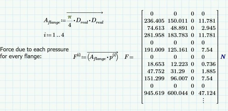

Instead of converting, better preventing.
Like this?:
Then do:
and

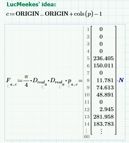

You’re right, Luck, it’s better to prevent than to correct, although I admit that sometimes I have trouble working with vectors and matrices in Mathcad. Clearly, there’s some concept I haven’t fully grasped yet!
You understood perfectly what I was looking for; however, I tried to implement the solution you proposed and it returns the values correctly, but in a single vector, as I show in the image below. To be able to work with this vector, I would need to later separate the values by columns for each case study.
Nevertheless, one of the colleagues who responded afterward came up with a valid solution that solves this problem. Thank you very much for taking the time to respond and help me. Much appreciated.

Forget what I said earlier, of course it works. I need to call the variable F without the subscripts afterward! My apologies!

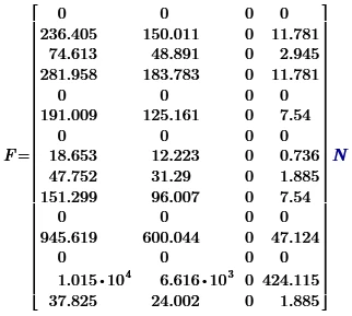

Better to produce an unested matrix like this:-

Thank you very much, Terry. Your solution works, but I found it easier to implement Werner's solution in my calculations. However, I will keep your solution for other applications; it's always useful to keep different tools in mind to solve the same problem.
Thanks again for taking the time to answer my modest question!

Werner_E25-Diamond IAnswer
Sep 2, 2024 2:01 PM UTC

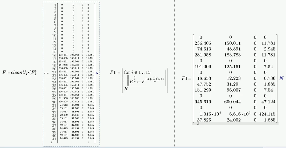

Sep 2, 2024 4:29 PM UTC

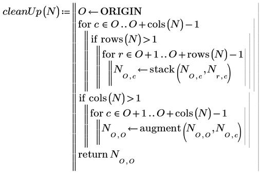

Just had a look why the cleanup functions of Valery and me did not work.
Valerys function was written specifically for the case that the inner matrices consist of one row only. Your inner matrices have 15 rows, so his function fails.
My function was a bit more generic, but it still fails in the special case that the input matrix would consist of just 1 row or just one column. Your nested matrix F is a vector with just one column ...
This could be fixed by adding two if-statements:
Now it works for your nested F as well, but because you created F to contain 15 matrices the size 15 x 4, you get a 225 x 4 result.
This "cleaned" matrix contains the 15 rows you are looking for, but also 210 rows you can't need. The matrix consists of every value (15) in the D matrix combined with every row (15) in the p matrix, so you got 225 rows.
What you need from this matrix are lines 1 and then every 16th line -> 17, 33, 39,...225.
You could extract those lines to get the desired matrix, but I strongly would advise that you use one of the methods shown before by Luc. Terry or me.
BTW, when you retyped my cleanUp function you made a mistake - the second loop with c should not be nested in the first one.
