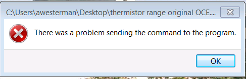

Recently I have had a problem when double clicking on Mathcad files and mathcad is not already running.
the first time will open a messagebox:
and opens mathcad (but not the file).
the second time I double click on the same file,even if mathcad has been closed, works properly.
the third gets the messagebox but does not open mathcad
the fourth works OK again ...
If mathcad is open, it works every time!

You probably had searched the net yourself already and found a lot of results, most of them dealing with Excel or Word. Usual procedure seems to be to turn off Dynamic Data Exchange. Excel seems to have a switch for that in its options.
As an aletrnative you may delete the Ddeexec key completely for the file extension in the registry .
Path is: HKEY_CLASSE_ROOT\Mathcad xmcd\Shell\Open\Ddeexec
Do the same for the other extensions like xmcdz and maye also the template extensions.
Others suggest to delete the "command" key (also under "open") as it may contain an invalid string, but I guess if this would be the case it wouldn't work every second time.
Keep in mind that when fiddling around with the registry its a good idea to make a backup first - export the key you intend to delete to a file first.

Hi All,
I had thought that this was a fix for it yesterday:
Made a restore point,
exported the strings & deleted entry in registry,
on re-boot as expected can't open mathcad with click from explorer.
Imported strings back into registry & seemed to be OK after re-boot, but on re-boot this morning, it was back to the same problem!. since then it has 'fixed' itself again - so I guess that I don't understand the rules properly yet.
