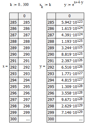

Sorry, may be I do not understand some one, but where is the problem:
November 28, 2013
Thats the problem:
Those two values are demanded to be the same.
November 28, 2013
You demand the impossible (assuming you expect real values).
You will only get solutions (two for each value of x) for x <= -2.383.
You may get them using a solve block.

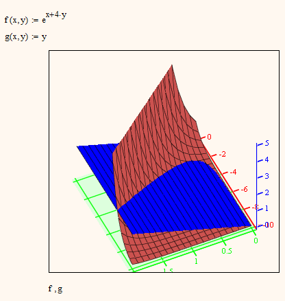

November 29, 2013
Here is a sheet that should help and an animation demonstrating why values of x must be smaller than -2.383..
I still think that number should be -1-ln(4) and Mathcad allows for slightly bigger values only because of numerical inaccuracies in the solve block - anybody any comments on that?
A more detailled video (higher FRAME number) was uploaded here: http://communities.ptc.com/videos/4498
EDIT: Added 3D-plot

I agree with Werner. I find the easiest way to think about this is to take logs:
Alan
November 29, 2013
Fine approach!
So -1-ln(4) definitely is the largest value allowed for x.

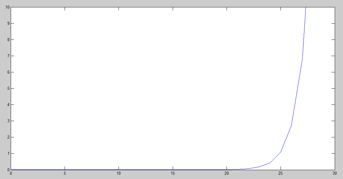

Matlab.pngI'm trying to apply this concept to another equation(same form as above). I don't know what i'm doing wrong but i'm not getting the range of values of y that i'm supposed to get.
I also plotted the equation using Mathlab just to verify. I'll be grateful if you could have a look at it. Thanks.
November 29, 2013
See attached for what I get with Mathcad.
Alan
November 29, 2013
I made a mistake in the Mathcad file. Thanks again for helping me out.
