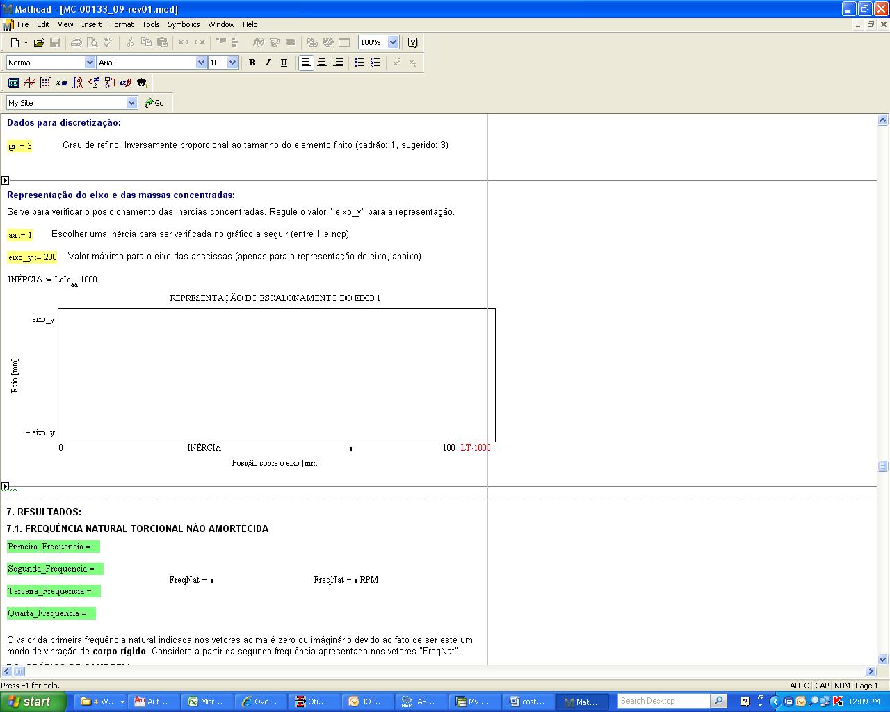

I have data sheet created in Mathcad 2000 which is an array.
If I try to open it in Mathcad 15, the graph plotted in 2000 is not working.
Is it a bug? I have no go, have to work with Mathcad 15. Kindly suggest a solution.

dm-31-VisitorAuthor
October 19, 2011
Alan,
I can send you a screen shot of the sheet considering confidentiality issues.
Sheet is not in English, its in Portugese language.
Dhinesh
October 19, 2011
I was going to load the worksheet into an earlier version of Mathcad (like 11 and 13) and see if the problem occurred there. Can't tell from the screenshot so I'm no help here I'm afraid - sorry!
Alan
October 19, 2011
Without a worksheet it will be impossible to find a solution. Can you try and replicate the problem?
Mike
dm-31-VisitorAuthor
October 19, 2011
PFA
Dhinesh
October 19, 2011
Please see the attached file (for Mathcad 15).
