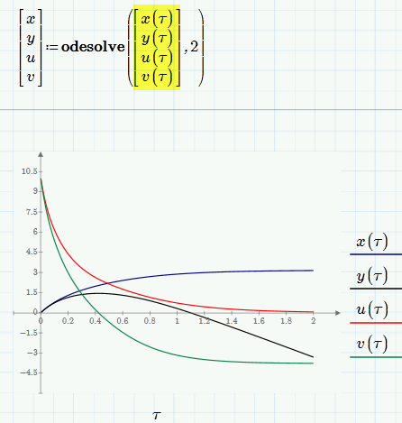

Hello everyone. I am trying to solve differential equation of water drop movement in Mathcad Prime 2. I have written all the input and solve blocks, but my file is not giving me output. The file is attached. Please anybody help me.
Thank you.
Best answer by Werner_E
Wrong odesolve syntax.
You have to put the functions in a vector.
See attached
Werner_E25-Diamond IAnswer
October 21, 2013
See attached
October 21, 2013
Werner Exinger, Thanks a lot.
