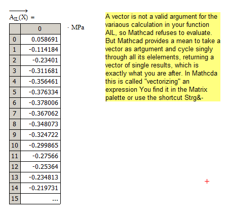

i'm working on an equation relates to the differentiation in a range of value.
The problem is i could not get the result for each value within the range unless i manually insert it.
here i attached my working spreadsheet for better understanding.

Best answer by Werner_E
You will have to vectorize your expression:
Werner_E25-Diamond IAnswer
May 8, 2013
May 8, 2013
Also, you could define r(X) more succinctly, and predefine your derivative functions too - see attached.
