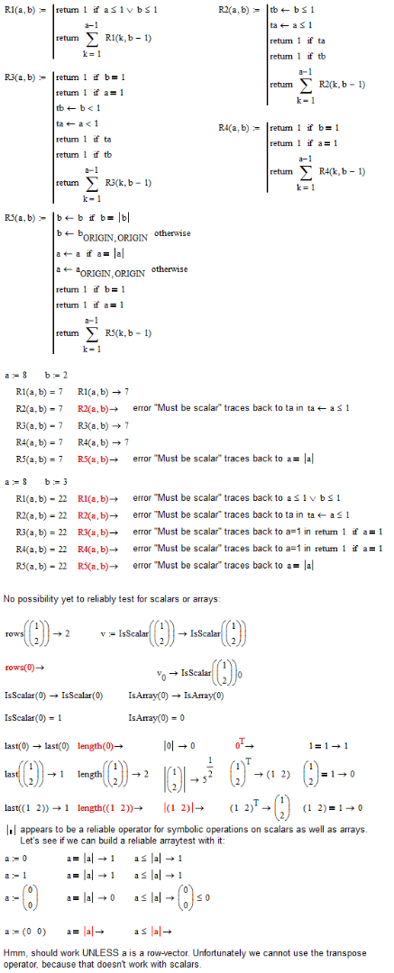

I think "pattern match exception" means Mathcad can't understand the syntax. It's not only associated with the symbolic processor, so I assume the parser does not know how to convert the expression to something the symbolic processor might understand.
This also gives a pattern match exception, which traces back to the local range definition:
23-Emerald V
This is what Mathcad 11 makes of it:
As you can see, if b=2 a symbolic solution is found (and equal to the numeric solution, fortunately), but for larger values an error is thrown.
Now the error is: "Must be scalar" and traces back to the condition in the if statement.
I haven't been able to solve that, yet.

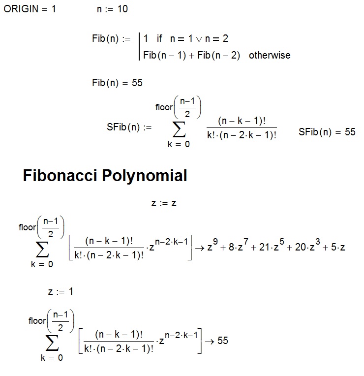

-MFra-
Indeed, mine is not a solution of your problem, it is only a joke ... a digression on the subject ... I have understood well your problem. You should turn to those who designed and wrote the software. My hidden message is that when I meet an impossible problem, or I fix it again, or try to avoid it by finding other ways to solve it.
However, all my respect for your prestige, but in much of the globe, currently, anyone can answer any question in its own way even if off topic. I'm sorry, but it is the free will ....
Regards.
F. M.

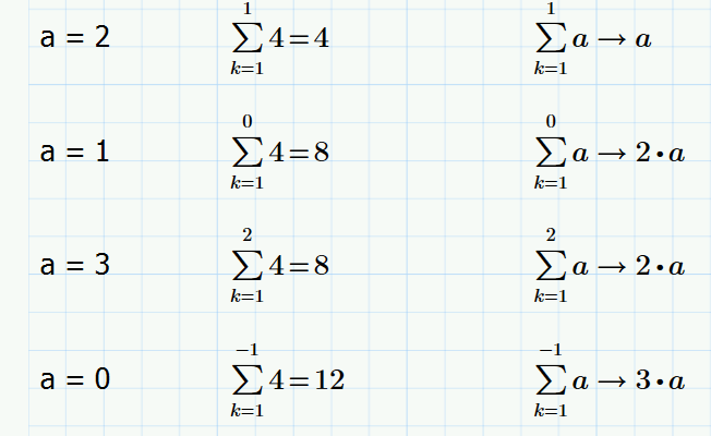

I'm afraid it can't be solved the way you'd like, because I think the summation operator symbolically produces a row vector here. I've tried many ways to get around that. If you think of any other ways, just let me know and I'll try them.

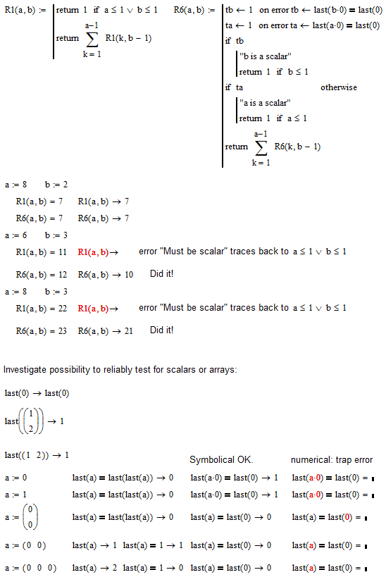

23-Emerald V
OK. I tried it one more time.
Now you get a symbolic result, but it's one less than the desired result. And if you evaluate it numerically, you get one more than the desired result.
Here goes:

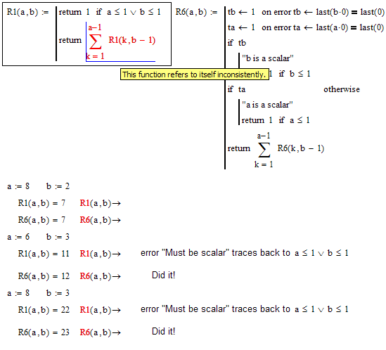

Werner_E25-Diamond IAuthor
Thats strange, indeed and it does not work in Mathcad 15 the way you show (see screenshot below). The error always traces to "This function refers to itself inconsistently".
It looks to me like Richards answer ("it's a case that is not accounted for in the parser to the symbolic engine") is the correct one.
So we can see it as a bug or a limitation (which should not be there or at least should be documented).
It also seems that reprogramming the sum as I had done is the only workaround so far - apart from turning the whole recursion into an iteration or even in a closed formula, if possible at all.
Thank for all the replies!
Werner
EDIT: Here's the promised screenshot:
