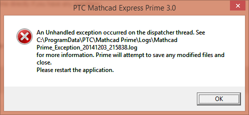

Have you tried re-installing?
Yes, I have re-installed four times and nothing changes
The same problem came up here a few times with Prime 1 and especially Prime 2.
E.g.: http://communities.ptc.com/thread/37826
or http://communities.ptc.com/thread/41349
As far as I am aware there was no general solution posted. In one thread it is suggested to change the Languange - nor sure if this would help.
If the problem persist after a reinstallation, I would contact PTC support.
Changing language didn't help
So you should contact PTC support.
Even if not under maintainance I guess you will get support for installation problems with the Express version.
http://www.ptc.com/support/mathcad_supportCenterOpt.htm
What Windows OS are you using? Try to install the following Microsoft components:
  • Microsoft .NET Framework 4.0;
  • MSXML 4.0 SP2.
