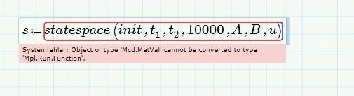

I have got a problem with the statespace solver.
August 6, 2012
This is clearly a bug. You should report it to PTC.
August 7, 2012
Can you upload your Mathcad worksheet?

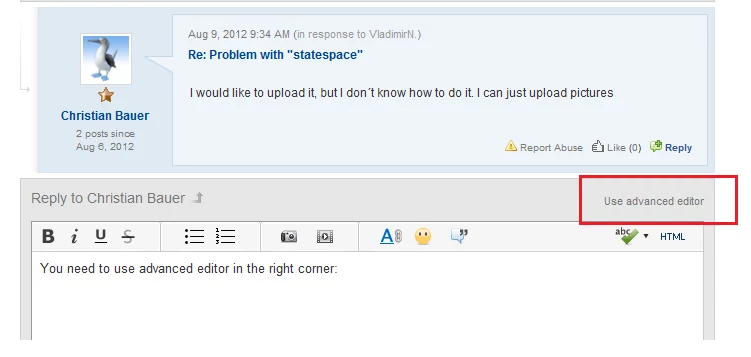

I would like to upload it, but I don´t know how to do it. I can just upload pictures
August 9, 2012
You need to use advanced editor in the right corner:

Attached the script. You need to make sure that the path to the three *.dat files is correct
August 9, 2012
Hello Christian,
the 'Statespace' function seems to need the A, B and u parameters speified asfunctions of time so need to define them as :-
A(t):= ...
After that the function gives an answer - right or wrong I have no idea.
