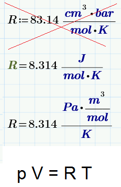

March 21, 2014
Sorry, R is a built-in constant:
