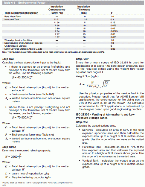

I know that there were many discussions about units but I cannot find(understand) help for my issue. I am trying to put in units but failed. I need Q in Watts, W in kg/h and show C in units like it is given in API 520 I. I will be very grateful if someone can help, explain how to solve it.

Q in watts is not a heat, is a power, this is, how many units of heat energy flows at any second. For this case, the energy unit is Joule. Other usual unit could be BTU/hr or cal/sec. So, "correct" letter for that heat flow is "Q.dot".
Other variants of express "heat" are Q', Q'' and Q''', which usually represent heat by length, surface and volume, and the combination also, but less usual, of Q.dot', Q.dot'' and Q.dot'''
Finally, you have sometimes the convention that Q in uppercase is heat, but q could represent heat by kilogram or by mol, and the same combinations with primes and dots.
For the work and mechanical energy, have the same considerations.
W in kg/hr is bad, if W means as usual, work, and I can't interpret it as something like work, including the case that was not kg but kgf.
In many norms, as they are old, and the revisers don't want to improve so much, the conversion factors are inside the formulas, which is a very bad practice. In this cases, using mathcad, you must to take out those factors from the formulas, and rewrite them in a better form.
That seems to be the case for the formulas Q = 70900*1*Awet and W = 3600*Q/λ.
So, maybe could get better help if you put some picture of the formulation that want to use in mathcad.
Best regards.
Alvaro.

Seems that W mean "weight". In this case, kg/hr, which is a caudal, or "gasto" in spanish, where we use g or m.dot. Also, remember that a weight is a force, so use W can cause a lot of unnecessary confusion.
See this Pentair book.

You've defined Q as two numbers without units times an area.
How do you expect it to be Watts?  For Q to be Watts, 70900 needs units:
of mass/(time cubed)

Thank you all for comments, I changed speadsheet and it is works, but! I need A wetted in formula for Q in 0.82 power and when I make it units change again. What is the trick, please explain.

Hi.
Check w, I guess it is wrong.
The way that you solve the problem, is one. The other is changing the formulation, for example, eliminate the factor 3600 as it is a convertion factor, but with this you loose the book formula. Another is using the API description, where they say in which units variables must to be expresed, and divede by them. In your case, Aw/m^2. And multipliying the result by the unit in which the variable description say that the final result was expressed, in this case watts. This method is, for me, better. With that, don't need to express the FC factor with those strange units. See the picture attached, from the page 108 of the pdf that I was posted above.
Best regards.
Alvaro.

I am confused, you made w unitles and then add required unit?
