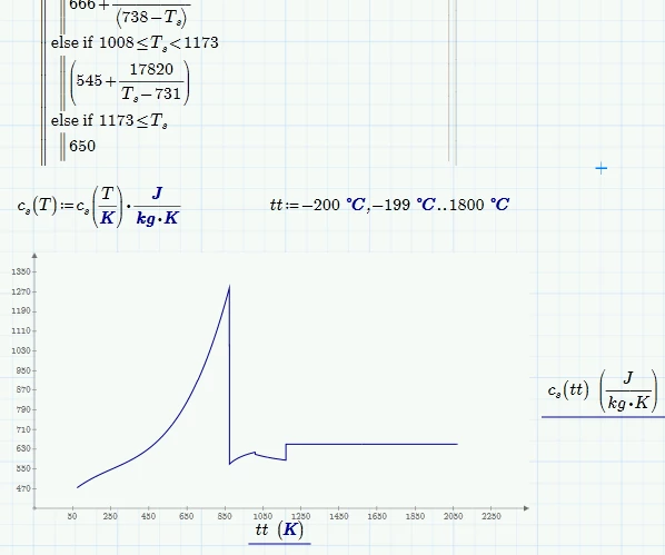

Mark!
Thanks for use my tip!
I think you must use units in Cs function too!
See the picture in attach!

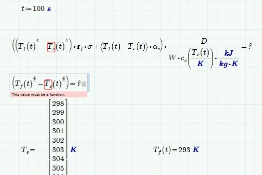

MBuck21-VisitorAuthor
September 18, 2011
Valery;
Thanks for the tip; as you can see it is better but still the ODE refuses to reveal the function for T.s i.e. the steel temperature at a given time due to heat transfer.
What else am I missing i.e. why are the units incompatible with the ODE solver?
Regards, Mark
September 18, 2011
See the picture and try please convert to order the right part of the ODE:
