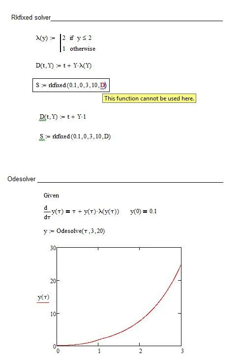

I want to put an Odesolver into a program, so I use rkfixed, but it is not working if I add the 'if statement'
\Anyone one know how to solve this?
Thanks!
Rong
Thanks!
Rong

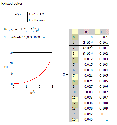

1) Send please the Mathcad file too.
2) We can use the odesolve function in a program to by a creating a user function f(...):= odesolve(...) and by colling this function f(...) in the program.

Thanks for reply!
Attached is the mathcad file. If you cannot open it, plz let me know.
And do you have example of function():=odesovler()
