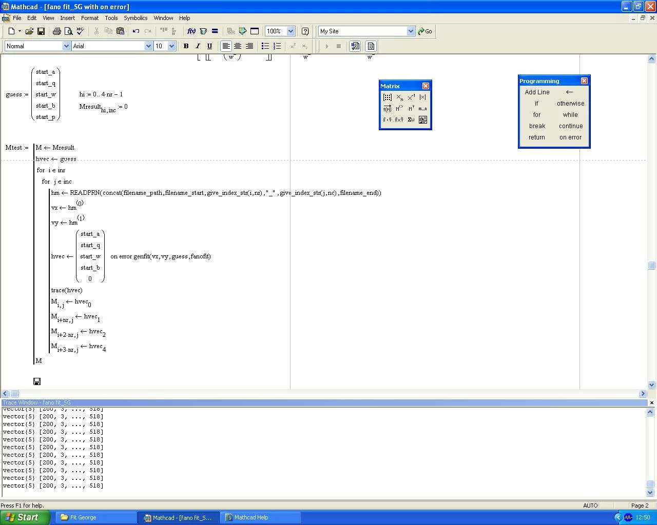

I'm not realy familiar with Matcad but have some programming experiences.
For a Mathcad (MC13) user I have to program the fitting of a large number of spectra. There will be spectra with no real solution (non convergence) always - so I have to handle the error. Mathcad give the phrase "on error". I tried to include it in my programm but it gives some strange results. There will be the calculation of a vector hvec - without "on error" it ist a vector, with "on error" it is a scalar if there is not this "hvec <- guess" initial step on top of the program part.

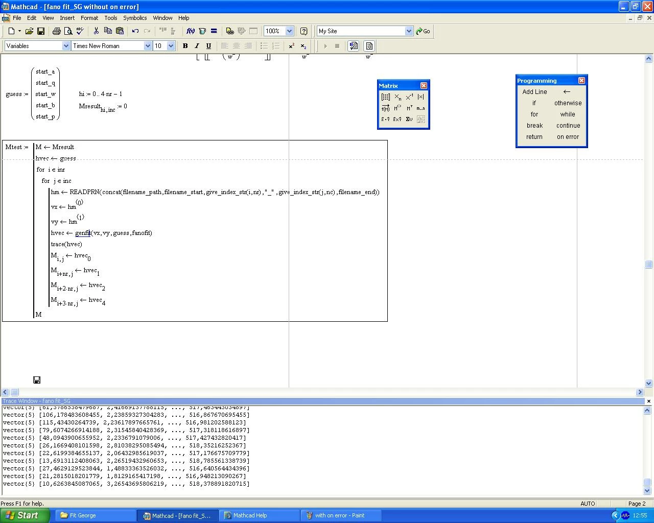

I get normal results if I not include "on rrror" -> see "MC11 fano fit_SG without on error.mcd" (MC11) and "without on error.jpg"
Using "on error" hvec ist always the value off the initial step "hvec <- guess" if the4 calculation is ok, if there is an error hvec is that what I wrote left of "on error" -> see "MC11 fano fit_SG with on error.mcd" and "without on error.jpg".
What do I wrong?
Can someone help me?
Arne

Arne Bochmann wrote:
The fitting works well without "on error" (despite the convergence problems) but with "on error" not so I wasn't thinking about that it relies to the datas.
The fitting is not likely to throw an error even for very bad spectra. It may take a very long time to converge, and the parameters will be garbage, but it will converge to something.
Some news: the version without "on error" works for this data set now - I saved it in MCAD11 and reopen again (MCAD13) - there were now convergence problems anymore but long caculation times for some spectra. Could be related to the MCAD11 save or that I use the debugging now - that behavior I have seen in other systems
The file version used to save will have no effect on the convergence times. The trace window might, but it's not much (I timed it to be sure of that). Some of your spectra do have very long calculation times, but it's only a couple of them. They look very strange: the signal level is not much different to adjacent pixels, but the noise is much higher and the baselines are screwed up. I don't know what would cause that (Raman is something I do have a lot of experience with). Some of the spectra have bad cosmic ray spikes too, but they do not seem to affect the convergence time. They actually don't seem to affect the fit that much either, but it would be better if you removed them. The fitting can be greatly sped up by switching from genfit to minerr: see the attached worksheet.
But I would like to work with "on error" because there will be arbitary datasets with wrong spectra for sure because there is not everywere silicon what we looking for but dust or something else - wromg spectra means not to match noise but no real data to fit.
As I mentioned above, that will usually not cause it to fail to converge though. It will just give you garbage results. It will also give you very large RMS residuals, so you can easily identify those spectra after the fit. Then you could replace them with the average of the nearest neighbors.
The "on error" version doesn't work even with MCAD11 save!
The file version will make no difference to what works after the file is reloaded, except to the extent that certain things that are not supported in earlier versions will have been removed during the save. The things that are removed are only those things that cannot be saved in the older format, not things that simply did not work in earlier versions. An example would be the secondary axis on 2D graphs.
This inc "illegal context" I haven't get - it works fine (MCAD13)?!
That's because you used range variables in the loop defintions in the program. That's not supported in version 11.

Dear Richard!
Great thanks for helping - I have seen my problem in on error now! Thanks for the new program too! I will delete my old stuff and rearrange a little bit - so my colleague can work with.
With the cosmic spikes and high noise or wrong data - as long as this is happen to minorr number of points only this ist no problem.
