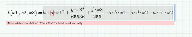

I'm pretty new to mathcad and I'm having problems getting polyfitc to do what I want.
I have a matrix with independed data and a matrix with depended data and the following model function I want to map to is.
how do I get this model formula into polyfitc?
update: I have added an example sheet. Problem with genfit and leastsquaresfit is that it is a multi variant regression

In your worksheet your Y data is also included in your X data! I suspect you don't mean this!

hi alan,
thanks for you help.
I need to use the fitting model as I wrote it in my original file due to easier computation in a microcontroller.
I had investigated the simplified model as you wrote it but that was not going to work out in the micro.
I found that multidfit function can be used with my own fitting function.
The only thing I miss is statistics about the regression model generated by multidfit.
I have to do this by hand but that was not a real problem.
