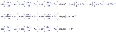

Hello all,
several days ago, I've updated my MathCad version to Prime 7.0.0.0.
However, now I'm facing problems with my old scripts as it seems that the new version is not able to simplify as good as the old version.
For example:2021-11-24_09h33_45.png
Obviously, the equation is 0 if test is a real number.
Also, the equation was simplified to 0 in the old version.
Even if I set test = 1, it is not simplified:
Is there any possibility to improve this new behavior?
Or is a different semantic required in the new version?
Thanks in advance and best regards!

EDIT: I just played around with your expression and tried "assume, test=real", "simplify,max", "factor" to no avail.
BUT ... when you use "expand" instead of "simplify", even the new symbolic engine is able to simplify the expression to zero:

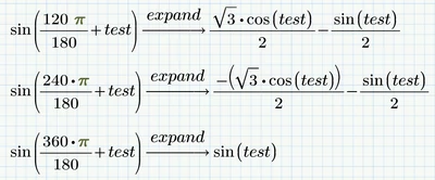

Don't ask me me "why" Prime can't find that most simply results on its own or for a logic behind it - its unfortunately just a matter of playing around and trial and error.
The reason why it works seems to be because "expand" in first place expands every single summand and as you can see below even a child can see now that the sum is zero:

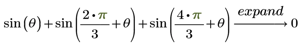

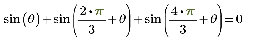

I can't see the point in showing that the result is zero for just one specific value of theta and that Prime can show it numerically and symbolically.
MR_9862891 knows that the result is zero for any real value of test or theta in your post.
The problem is, that the new symbolic does not simplify to zero as it should and as the old engine did without problems and hesitation.
At least not when you use "simplify". As I had shown in my answer using "expand" does the job in this case. But thats not really satisfying as "simplify" should do the job as well.
