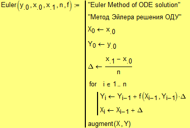

I have to create a program for Euler's method. This is what I have so far. Any help would be appreciated.
May 6, 2013
You will have to use vector indices in your prog, not the literal index as you did in some cases.
The way you have written it, vector y will consist of a bunch of zeros!!
May 7, 2013
I changed them but now is says my y[i+1 is undefined?
May 7, 2013
Maybe something went wrong in deleting the literal index. Delete the whole index and retype it, that should work.

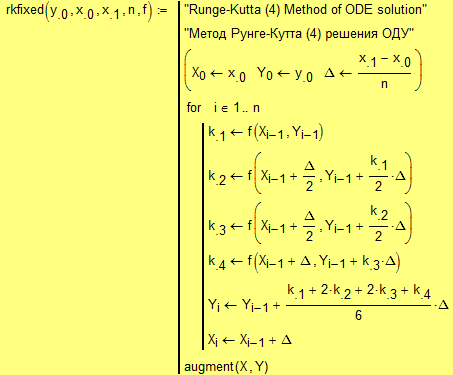

May 6, 2013
...and Runge-Kutta as a compliment...
