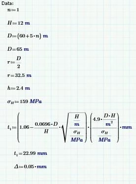

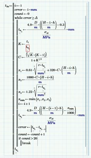

I'm need to calculate thickness of segments of the wall for container. It's sort of empirical method(so there is bit mess with units) and requires simple iteration.
I had done some programming in Mathcad prime succesfully, but now I can't find where my mistake is.
I'm attaching sheet and imgs.
Thank you for any kind of help.

For i=5 x2=0, then i is incremented and tn6=0. Next you divide by tn6 and this throws the error. See attached.
Unfortunately Prime does not have any serious debugging tools like real Mathcad (15) has.
You may reconsider and check you iteraton formulas.

Wow, I was so blinded.
Thank you for finding my mistake. Indeed my formulas was faulty.
