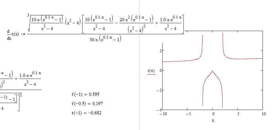

Now it looks better. It is necessary to understand some areas of the document with text alignment and plots. Such this:
June 22, 2011
I used this graph when I was trying to find functions which converge to the desired solution.
The "fixed point method " (I think this is the correct name) is the only which is built on specially for f(x) function, i.e. the program (I suppose) will not work for any other function.
