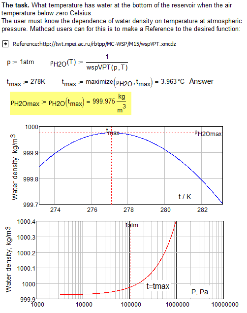

Properties of water and steam by IAPWS-IF97 formulation - part 2

See the picture and use please the attached Mathcad 15 worksheet:
