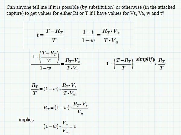

I am working on a bigger Ship Propulsion problem.
I have got to one of those scenarios where it feels like I am missing an input in order to get the ultimate solution.
Can anyone tell me if it is possible (by substitution) or otherwise (in the attached capture) to get values for either Rt or T if I have values for Vs, Va, w and t?
using MC's Symbolics it suggests not but it must be possible?
Andy.

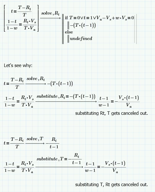

September 26, 2017
(MP3.1 attached)

Hi Guys,
Thanks very much. I think I have (through reading the question again) worked another method.
I agree my post is not possible.
One thing I am interested in is MJG's definition of the two equations in square brakcets. How has this been done i.e. what is the region which the symbolic solve has then been applied to?
Andy.
September 26, 2017
Andy,
The square brackets are a 2x1 matrix.
