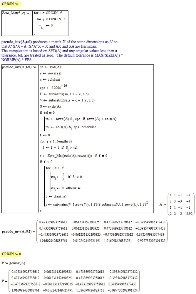

@Michael2 wrote:
Do any of you have a script for calculating a pseudoinverse matrix nxm?
I found a script here, but it is written in Mathcad 15 and unfortunately I don't have a licence to convert it to prime.
https://community.ptc.com/t5/Mathcad/Programming-example/td-p/229552
Michael
If you don't have a licence to convert it means that you are using the free Express version of Prime and are past the trial period.
In this case the converted sheet won't help as programming is disabled in Express.
For calculating the pseudoinverse you may use the built-in function "geninv". Its not a premium function and works in Express as well.
In case you are just curious here is a screenshot of the original file (btw, setting ORIGIN:=0 at the end would not be necessary at all)
EDIT: Wasn't aware that it still would work, but it did, so find attached the file converted to Prime 6. You should be able to open it with Prime 7.

Aug 8, 2024 3:47 PM UTC
I think that starting with Prime 7 the installation was self-contained in the sense that no extra installation of MC15 was necessary to do the conversions.
But when you install Prime the check box to install the converter as well must be actively checked, its not checked by default.
You always can rerun the installer to add the converter to your installation if it wasn't done in the first place.
