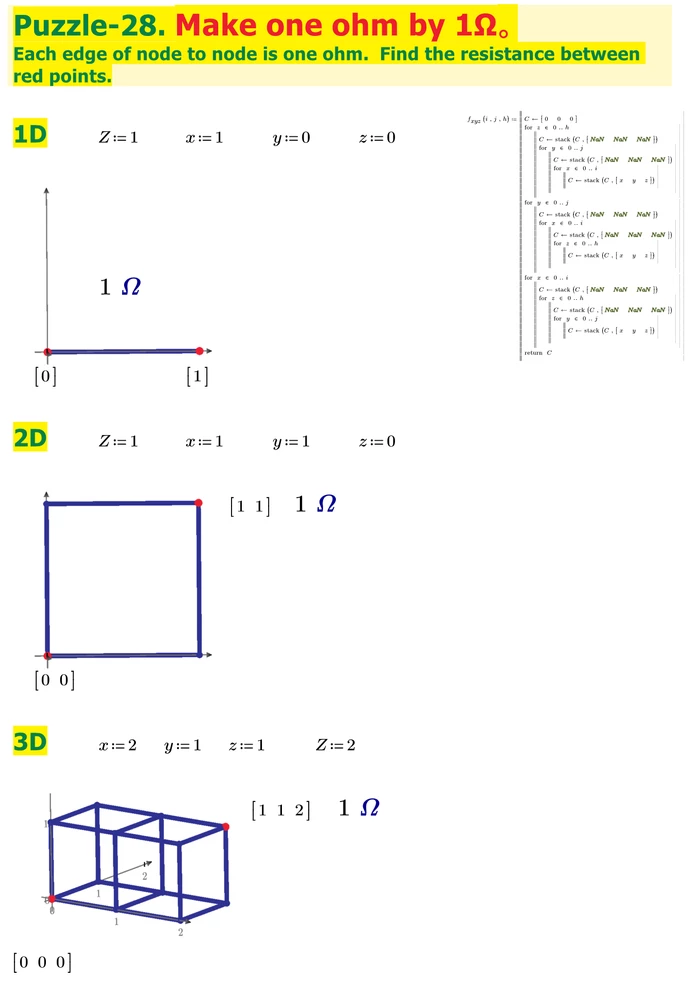

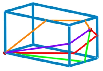

Puzzle 28 Find the most far point from [0 0 0].
Make 1 ohm by 1 ohms is my best electric circuit puzzles.
I show the 1D, 2D and 3D lattice answers. Maybe these are the only one solution for each dimension.

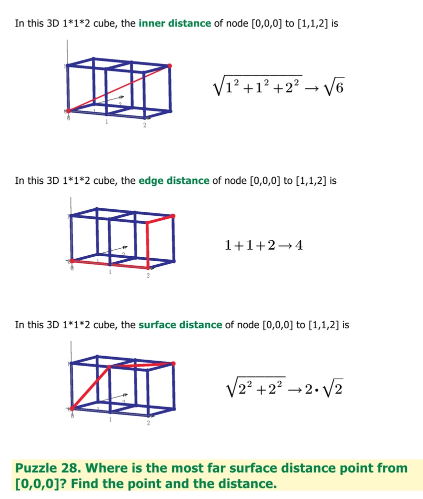

Puzzle 28 is using this 3D lattice shape 1*1*2. Where is the most far surface distance point from [0,0,0]?
Find the point and the distance.

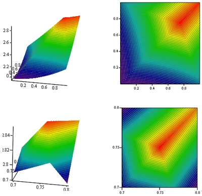

@ttokoro wrote:
For the 3*4*5 cube, the surface distance of [0,0,0]-[3,4,5] is.
Yes, but.... I thought the task is to find the point with the largest surface distance from (0;0;0) in a 1 x 1 x 2 cuboid.
And I would say that (0.75; 0.75; 2) would be a good candidate:
There are four possible ways from (0;0;0) to (0.75; 0.75; 2), all the same length!
But I am missing a true proof that its really the point with the largest distance. I just have a numerical
and an optical confirmation

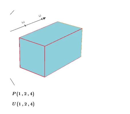

The 3D object you show consists of line segments only. You will have to define what exactly you would like to call a "surface" and how exactly you would like to define "surface distance" of two "points". I assume that with "points" you only mean the endpoints of the line segments.

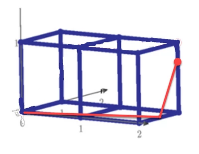

ttokoro
ttokoro21-Topaz IAuthor
Jan 12, 2023 11:21 PM UTC
In this puzzle, surface means the surface on the 1*1*2 cube as shown below in blue color.
Point means any point on the surface and not only the integer nodes.
Distance means the shortest way by connecting two points by string on the surface.
t.t.

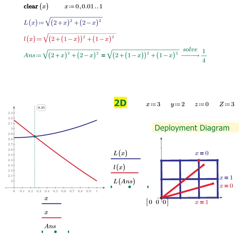

Jan 12, 2023 9:05 PM UTC
That could be any point on the block, depending how many times you want to go around.
Limiting myself to go from 0,0,0 to 1,1,2, I could also go from 0,0,0 to 0,1/2,2, and from there to 1,1,2, then the 'surface distance is:
or go from 0,0,0 to 0,1/3,2 and then on to 1,1,2, which gives:
better still, choose any fraction delta and go via 0,delta,2 to 1,1,2 gives at maximum:
all of which is more than
ttokoro
Jan 12, 2023 11:40 PM UTC
Thanks. Sorry my explanation is poor.
Start point is fixed to [0,0,0]. End point is not fixed to [1,1,2] but any point on the surface. So, find the most far point on the surface from [0,0,0].
The surface distance from [0,0,0] to [1,1,2] is "the shortest way" on the surface and it is 2*sqrt(2).
(The surface distance from [0,0,0] to [1,1,1] is "the shortest way" on the surface and it is sqrt(5).)
Tokoro.
t.t.
Jan 13, 2023 1:44 AM UTC
So the surface distance from (0;0;0) to (1;0.8;2) is 1/5*sqrt(221)=2.973...  ?

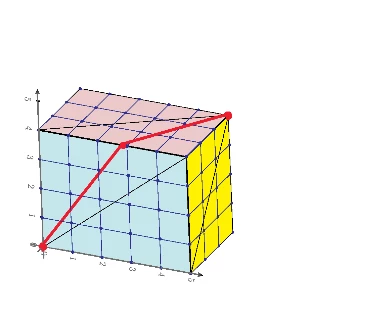

ttokoro
Jan 14, 2023 7:33 AM UTC
t.t.
Werner_E25-Diamond IAnswer
Jan 14, 2023 9:20 AM UTC
ttokoro
Jan 15, 2023 1:36 AM UTC
Then, the last question is what is the largest surface distance  on a 1 x 1 x 2 cuboid?
It means we need two points on the surface and the distance is larger than above result.
