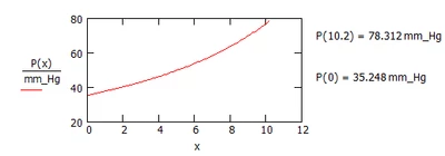

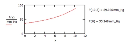

@FDS I think I've found the culprit.
In Maple your differential equation is:
resulting in:
In Mathcad you've implemented:
Resulting in:
That's  a small jump for an exponent...

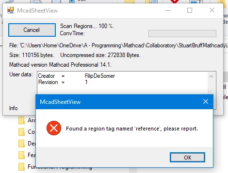

I've tried @LucMeekes's file viewer but it has a problem with part of the xmcdz file.
