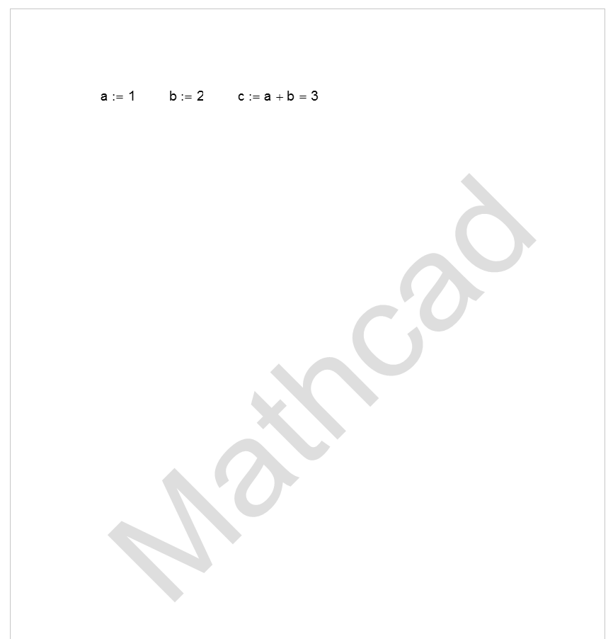

September 13, 2016
We can save Mathcad-sheet 15 as a rtf file, open it in Word and create watermarks - see please the picture:

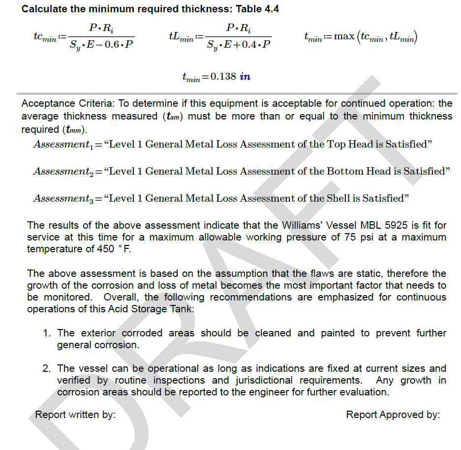

Thank you all who took the time to comment on my situation. I wasn't to familiar with the way the new Adobe Acrobat XI looked or worked. After many hours of research, it only took less than 2 minutes to fix the problem.
  1. Go to the tab "Customize", and click "Create New Tool Set.."
  2. Find the tab "Pages" and scroll down to Watermarks
Please see an example below of the draft report completed in Mathcad Prime 3.1
