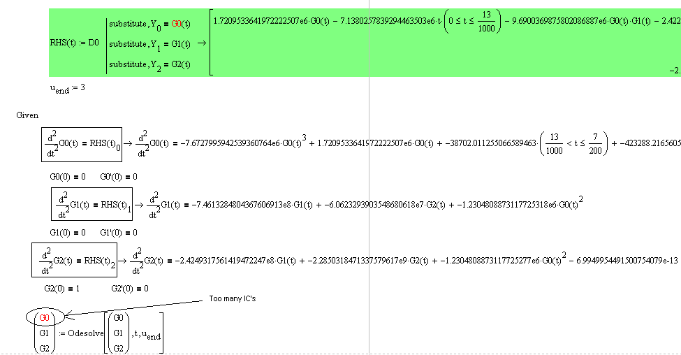

Hello everyone,
I have a system of 3 non linear equations second order differential.
I'm using radau solving the following system : d/dt (phi) = f(phi)
But i would like to solve the system d²/dt²(phi)= f(phi) instead.
My f(phi) is a three dimensionnal vector with non linear . coupled phi's
For example (i've removed sensitive data and simplified problem)
How would you format D(u,Y) ? I've tried with the other solvers but it didn't solve. I'm stuck with Radau.

What are the initial conditions for the three components of dYdu?
Alan
May 24, 2013
Attached is an example using Odesolve, with arbitrary initial first derivative values. Your system is very stiff!!
(The default integrator is BDF/Adams, but you can right-click on Odesolve and choose Radau if you want).
Alan
May 24, 2013
Ok thanks for the tip.
I've replaced the equations with the real system.and it's saying too many initial conditions. And doesn't solve.
I have 6 IC's
May 24, 2013
On the RHS of your equations you forgot to write the parameter parenthesis G2(t) - you simply wrote G2, etc.
May 24, 2013
Ok , it's working in the first sheet.
However when i'm transferring the method back to the second field. I have an error on G0 (too many IC's)
Here is the full sheet...
It's very long and it's at the end.
May 24, 2013
If you use only the result of the symbolic evaluation (the euqations itself) you get past this error, but you get a new one.
It only works if u.end is under 0.25, otherwise you get the following error :
May 24, 2013
If you use the Radau solver it does work. i have to compute u.end till tlast which is around 0.35. And solves.
Is there a way to get past this error without copying the whole thing equations again and again?
I'm making this CAD as a routine check for deflections compared with other FE softwares
I have a few steps after the solving and it's a bit annoying to have this.
The bdf/radau signal diverge? Let me check that out.
