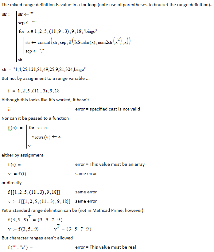

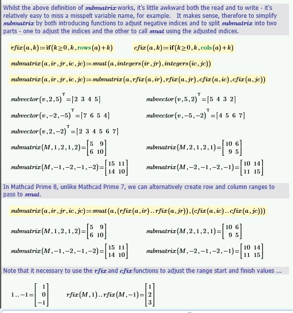

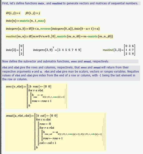

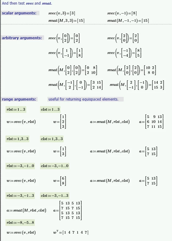

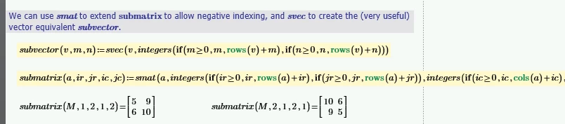

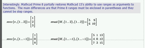

Whilst playing around with some array extraction functions, I noticed that Mathcad Prime 8 partially restores Mathcad 15's ability to directly use ranges as function arguments.

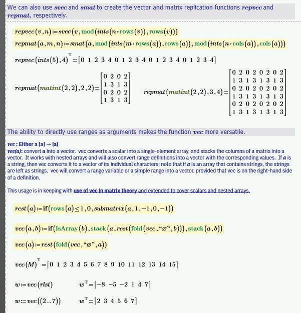

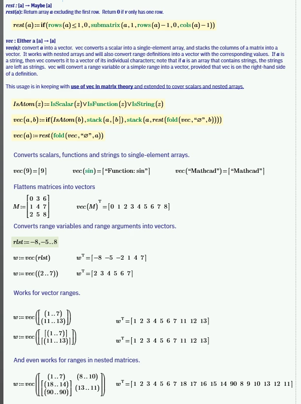

Here's vec modified to work in Mathcad Express 8 and operating over nested range arguments:
I created an IsAtom function to determine whether an argument is a scalar, function or string and assumed that anything else potentially has multiple elements (ie, is an array or a range).  There have been several occasions when an IsRange function would have been nice.
With my usual unbridled optimism, I hope the ability to use simple ranges as functions arguments is a foretaste of things to come - that is, fully stepped ranges and arbitrary sequences as arguments.   Indeed, I'd like to see proper, arbitrary sequences as a new data type.
