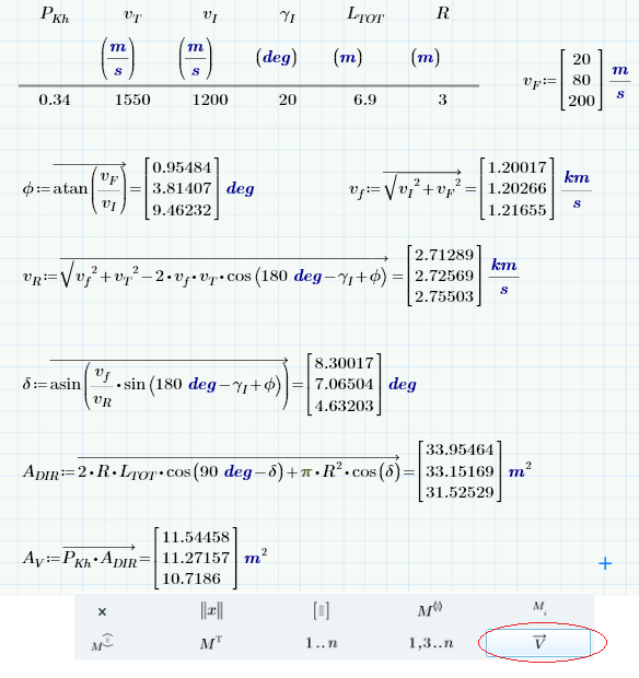

I'm attempting to work a physics problem which has a range of answers based of a range of values for VsubF. When I work th solution for a single value I get the answers I expect. However when I work the range function my Delta equation (marked with stars on file attached) only gives me a single value instead of a range as expected.
Is there a better way to work this so I get a range of values for my Delta equation and then also my Av equation? I attemped steppiing VsubF using 20,30,...200, but running into some issues there as well.

It will be good to use the vectorizition operator in all user's operators - see the picture and the attach:
See too http://communities.ptc.com/docs/DOC-2352

I fully agree Valery. The only issue I have with using the vectorize function is for ascetic reasons. It does tend to make the calculation complex.
