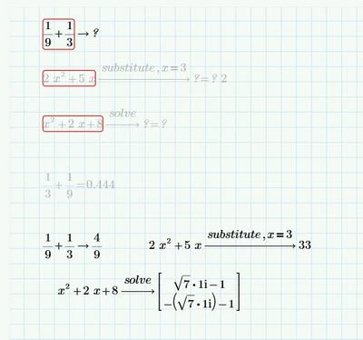

I am suffering a similar (though much more repeatable issue).
When we as a company upgraded to Prime I was the only one that could not use the symbolic engine & when I raised the issue it was fixed within 2 weeks.
Since then I have had a laptop upgrade & it has reappeared.
a repeat of the IT ticket has not resolved the issue.
Even the simplest task causes the symbolic engine to crash:
is the final response after many minutes of the sunflower twirling.
Sheet is attached, but probably not helpful as I can give it to colleagues who don't get the same problem. For them it quickly returns the expected 4/9result.

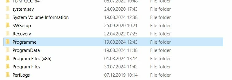

    Hi
    I finally got our company's necessary customer information to file a support case with PTC as suggested further below. They replied very quickly. I am working in an international company in Germany where  the Windows installations seem to vary between German and English (Excel commas and decimal places is a nightmare). In my case MathCad Prime was installed under Program Files / PTC. I also have PTC Creo View Express installed. PTC support told me  to install MC Prime under Programme. I did not have Programme only  Program Files and Program Files (x86). So  I created a Programme folder and it installed there under Mathcad Prime 9.0.0.0. This seemed to solve the problem for the moment anyway. Another colleague who had it also installed under Program Files, but without issues so far, suggested making a symbolic  link rather than reinstall, by executing the following command as an Administrator:
    mklink /D C:\Programme "C:\Program Files"
    I cannot vouch if that works. I followed the PTC advice and deinstalled and reinstalled under a new Programme folder and the Symbolic Engine started up.
    Andy G

    I do not understand why below shown expressions are displayed in grey color.
    Посмотрите, как получается, ваша запись и моя на одном листе, мистика?
    That is so strange!
    when I try to re-calculate the sheet (disable the original set  of equations), I still have the twirling sunflower.
    It will run for more than 5 minutes in this state.
    Unfortunately, all external communication is vis the corporate IT department, we don't have the contract numbers to verify the right to ask for help.
    This e-mail was added to an old chain to see if other users were experiencing the same issues & log it as a problem (if PTC monitor the forum).
    I assume that the 2nd & 3rd lines are grey because the calculation was stopped & these were left 'pending'.

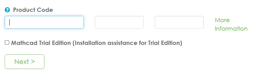

    open case at PTC Support and ask them to resolve the problem.
    Yes I will try Thanks. First I need to find the product code.
    All I see is a service contract number in the installation under the license. Can I get further using that?
    Andy
