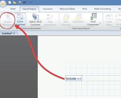

I tried to input the results from another mathcad file , but I guess I'm doing that wrong > in the following image I'm trying to import the results of ( R)
What is the correct function to import the results from one mathcad file to another?

Do you still see errors when you include the worksheet in a blank worksheet?  Does your new worksheet have the same ORIGIN  as the one you want to include?
Are you sure that there are -- no -- errors, even minor ones, in the original worksheet?  I've had cases where I left an evaluation with an error.  Although the rest of the worksheet was fine, that one error flagged the whole sheet as having errors when I included it.

You may want to lookup the syntax of READFILE in the help -> Search: READFILE
Was the file written by WRITEFILE?
The second parameter in READFILE should be the type, which can be "delimited", "fixed" or "Excel", but not "Mathcad Worksheet".

I am not sure what exactly you a trying to achieve.
Is the file you try to read from a Mathcad worksheet? Then you cannot read-in variables from it using any of the READ.... functions!
You could 'include' it
This acts as if the content of the included worksheet would have been typed in at the position of the "include". So of course you also have access to the variables therein.
If you just intend to transfer a couple of variables you may be better off if you save it (maybe as an Excel file using WRITEEXCEL or by using any of the other WRITE... functions) and use the corresponding READ.... function to read in the data. But we are talking about the numerical values only, units will get lost during that process and you would have to add them yourself after reading in the data.
