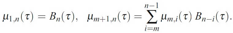

Hi, I met a problem when deriving a recursive symbolic function by MATHCAD, the orginal functions read:

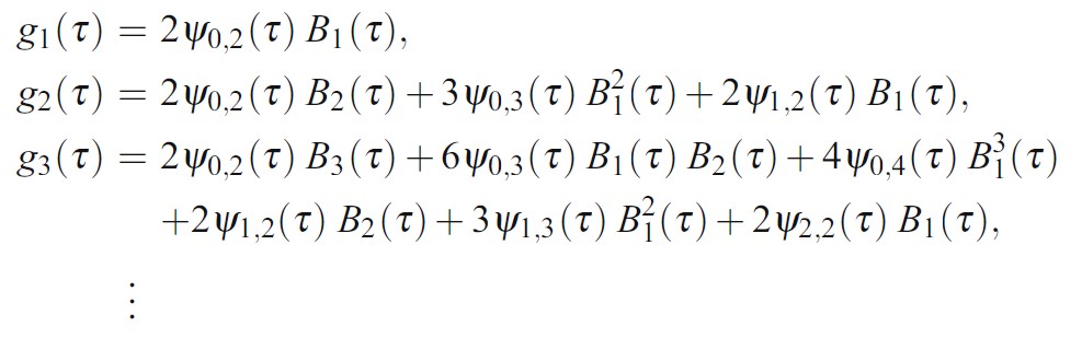

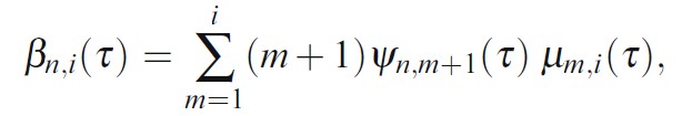

What I want is to derive the following recursive functions:
As function gn(t) will be becoming very complex, the rest of deviration work has to accomplished by computer, but I don't know how perfectly Mathcad can handle this problem. So if anyone has any avice, I will be extremely grateful!

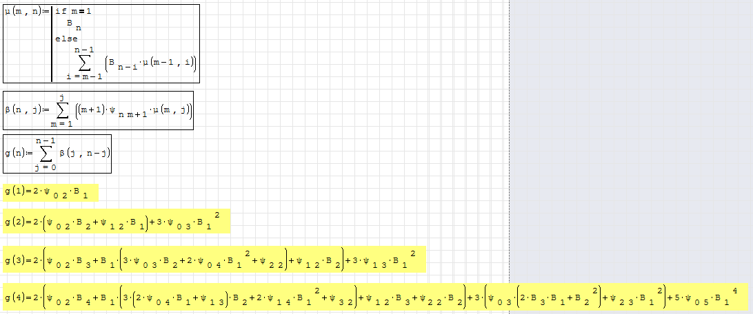

Is the attached any help? Mathcad won't do it symbolically, but numerically seems ok.
Alan

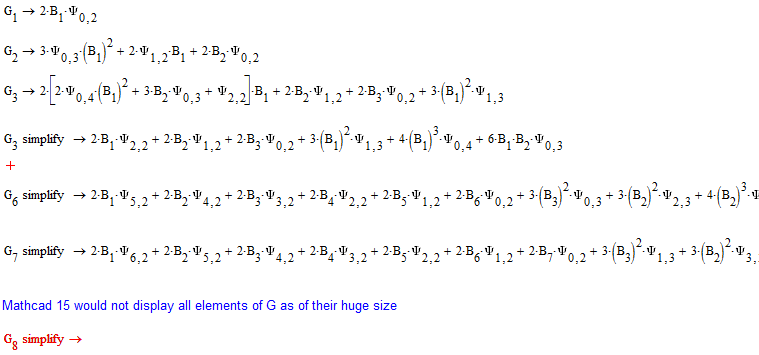

As Mathcad seems not be able to do the job, maybe using SMath (http://smath.info) could be a solution. It seems not implement that late binding of variables in symbolic mode and so we get the results demanded. Unfortunately the ability to symbolically simplify expressions (like simplify, expand, or factor) are nonexistent in SMath (yet).
August 27, 2013
To round it up after a long downtime of the Forum and to test that awful sounding new moderation scheme which I fear will be responsible for unaccaptable time delays, I attach a modified sheet in both SMath and Mathcad format.
In SMath the result was copied and assigned a variable and the sheet then exported in XMCD format. After some modifications in Mathcad the results are now useable in MC for simplification ot whatever you had in mind.
