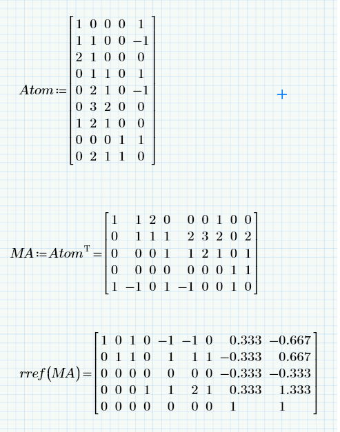

Good morning,
I am using the "erl" function to get the reduced row-echelon form of a mxn matrix. However, the results in MathCad 15 shows some fractions. If you make some han calculations you can get the unit form matrix (only 1/0 in the upper left portion of matrix) and thats the result that you get from other software like Maple, MatLab or making all reduction steps by hand. I am wondering if there is any way to get this from MathCad.
Oscar J.

Can you attach Mathcad worksheet?
OscarJ.1-VisitorAuthor
January 3, 2012
MathCad example.
Oscar J.
January 3, 2012
It seems that only Mathcad 11.0a gives the desired result (see the comparison of results below).
Mathcad 11.0a:
Mathcad 15 M010:
Mathcad Prime 1.0:

January 3, 2012
Oscar Delgado wrote:
Good morning,
I use MathCad in french. For me the function "rref" is "erl".
<<erl(A) renvoie la forme échelonnée réduite de A.>>
Oscar J.
