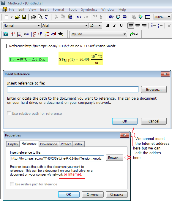

I thought that this is possible only in Mathcad MM.
But it works in Mathcad 15 too
Try please the file in attach and see the picture!
January 2, 2011
Worked.
Very nice Valery, could come in handy.
