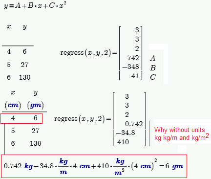

I'm surprised this worked at all! Wat units should y have? The polynomial (given x has units of length) has different units for each term. Version 15 solved the issue by refusing units; but if you put in "UnitsOf()" you get the same answer,

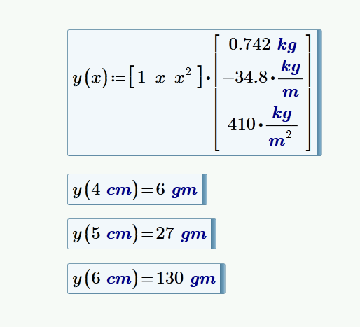

Result as attached would be OK

Yes, it would!
The challenge is to get Mathcad to get the units right for the automatic solution.
