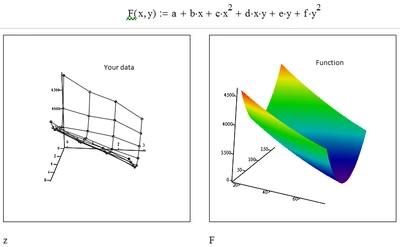

I want to find the function from 2 variables according to table data I have:
c t=16 t=25 t=50 t=75
0 4925 4511 4277 3845
20 4148 3975 3888 3564
40 3759 3672 3560 3327
60 3802 3586 3327 3111
80 3880 3664 3370 3025
100 4018 3698 3435 3089
120 4113 3802 3543 3240
140 4269 3932 3694 3435
160 4537 4104 3888 3629
I read a lot of info at this forum. I found good posts from @ValeryOchkov about the interpolation algo from 2 variables. I did it, but don't know how to get the function.
I attached a file with my experiments.  @ValeryOchkov maybe you can help me?
I am a newbie in Mathcad Prime, so please help me how to find the analytical function F(x,y) according to that data.
Thank you in advance!

See please the Mathcad 15 sheet in attach. You can convert it into Mathcad Prime. Or I can do it myself if you can't!
See please the picture! You can choose more optimal function for your data - not the 2-d order plane!

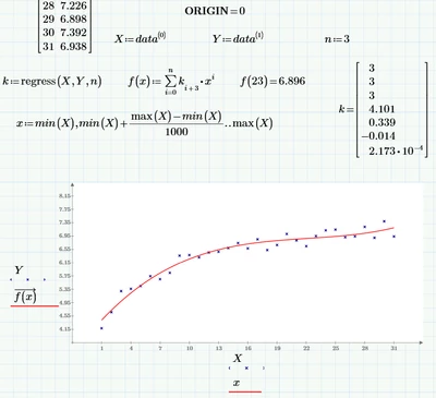

May by this article help you?
It is not an interpolation but an approximation!
http://twt.mpei.ac.ru/ochkov/car/c_e.html
December 4, 2018
… and one more - not linfit but regress

Thank you for reply! I saw yesterday similar topic  , but didn't understand how to use it in my case.
Also, in your tutorial I can't understand the "magic" of "Conversion from a Plane (fig. 2, fig. 3 and fig. 4) to a volume (fig. 1) gives the following regression formula[3]. With this formula, we calculate the minimum price of the car (% of the price of a new car[4]😞".
December 5, 2018

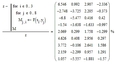

… but the 2-d surface is good - the max delta is 6.5%!
