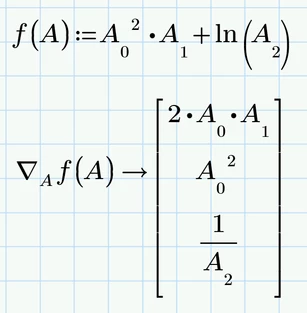

Its not really clear to me what you are actually trying to do and from the pics we don't see how you defined your variables and/or functions (I don't see any function in your pics!).
But its true that its a bad limitation of Prime that it can't handle vector functions pretty good and won't allow an indexed variable as variable of derivation.
Not sure but maybe the Nabla operator can be handy?
Hey, thanks for replying. Yea i couldn't explain the problem with the pics because the equations were too big. But you seem to have understood the problem anyways. I'll tr with the nabla operator now. i think it would work for me.
Thanks again for your help.
