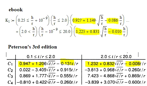

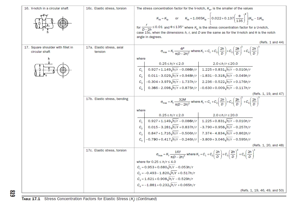

In mcad Roark's e-book 6th edition there is a worksheet to calculate the stress concentration (case 17b).
I just noted that the constants to calculate the values for C1, etc are different to the ones in the latest book (Petersons 3rd edition)
1. Am I correct?
2. I cannot find a 1974 copy 1st edition (I guess!)  which appear to be the reference used. Has anyone got access and could confirm?
3. Is it the same in the latest ebook which I think is based on Roark's 7th edition but as far as I can tell in the printed Roark's 7th edition the numbers are from the 1974 edition too
Regards

Thanks. I set-up the Kt calc as per Petersons 3rd edition and for my geometry I got 2.65. the formula in Roark's ebook gave me 2.64. So not going to lose sleep
The geo is irrelevant (but thanks for the offer) I am more concerned about the factors and the discrepancy

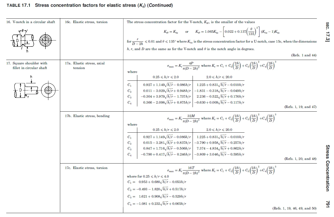

Not my area of expertise at all, but the table in the seventh edition I found here
http://materiales.azc.uam.mx/gjl/Clases/MA10_I/Roark%27s%20formulas%20for%20stress%20and%20strain.pdf
seems to correspond with the formula in the Mathcad sheet:

but as fas as I can see the constants in the calculation of the C values are not the one in Peterson 3rd edition
7th Edition:

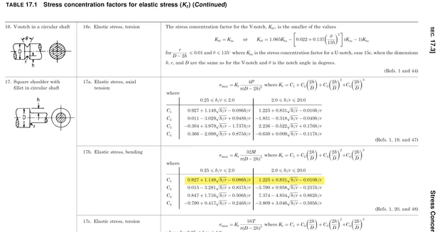

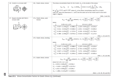

8th Edition:
P.S. Years of edition (from 9-th to 1-st): 2020, 2012, 2002, 1989, 1975, 1965, 1954, 1943, 1938.

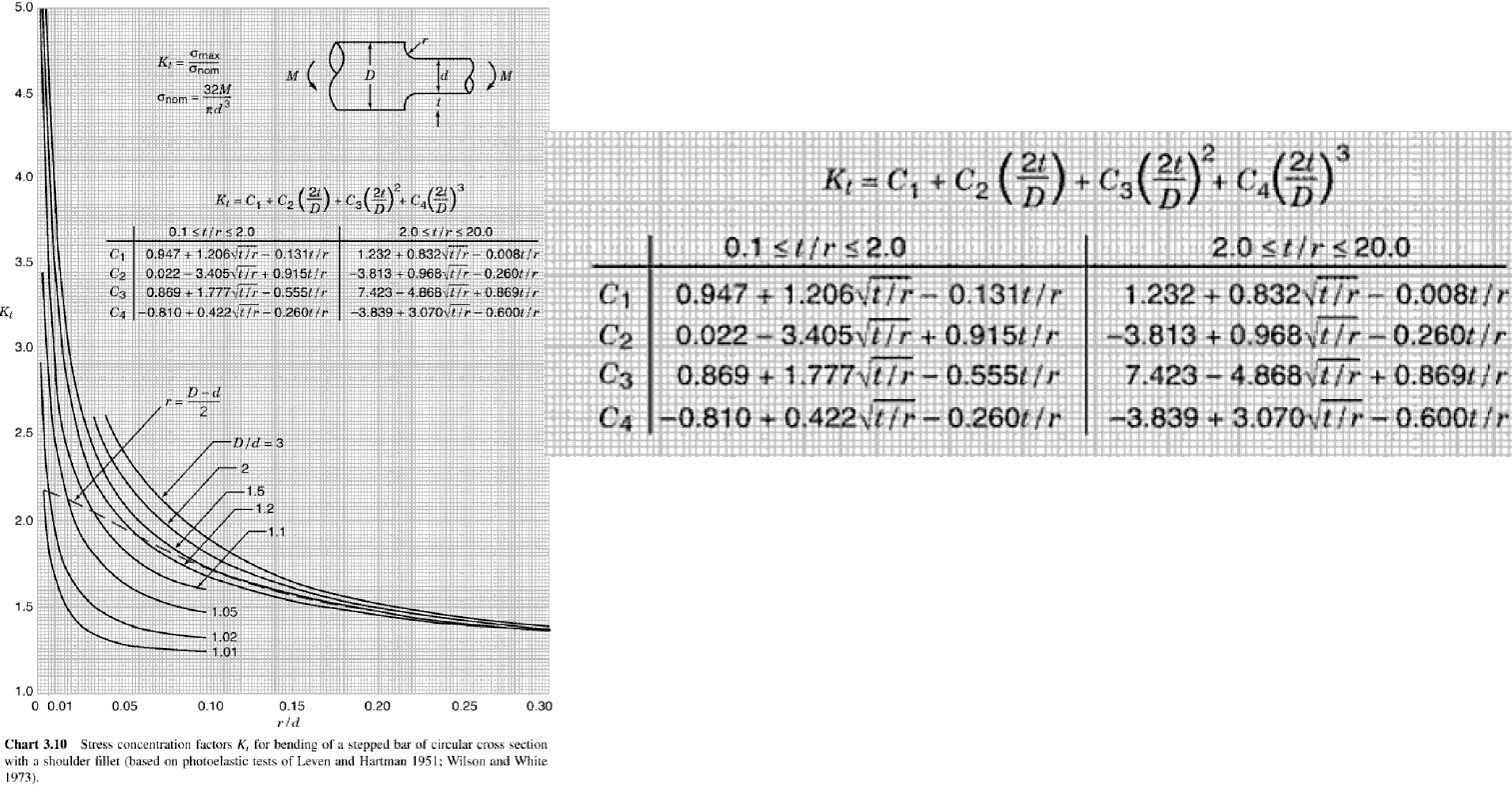

as per the original poster question I had a look at my copy of Petersons and indeed it seems that the constants defined in the C values are different - see attached Chart 3.10 from Peterson
The Roark's data seems to be pointing to the 1st edition of Peterson

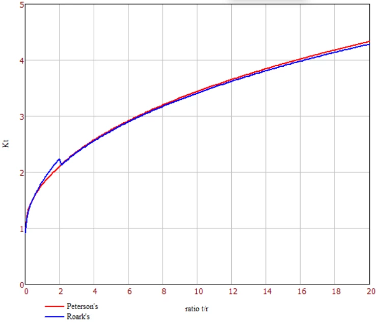

@JXBWk The difference appears to be academic in this case - see graph attached (an "issue" at t/r = 2.0 possibly but I may have a made a mistake in typing the numbers!) but I get your point. One difference also is that the 1st set of C values are for 0.1 <= t/r <= 2.0 where in Roark's it is for 0.25 <=t/r<= 2.0

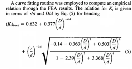

Peterson's also gives an equation for Kt bending, eq 3.7 - taken from Tipton et All (see attached), but if I "code" it get an imaginary number out of it !!
Tried with D = 200, d=100, r15 and I get 0.65+0.479i
Obviously does make sense - What I am doing wrong?
