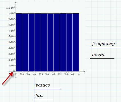

I am plotting the histogram of the random numbers generated by the runif(n,0,1) function.
Even for big n the distribution I get is not uniform.
What is wrong?
thanks!
Best answer by Werner_E
What is wrong?
Prime's autoscale. Look at the lowest value at the ordinate and change it to zero.
Werner_E25-Diamond IAnswer
April 24, 2014
What is wrong?
