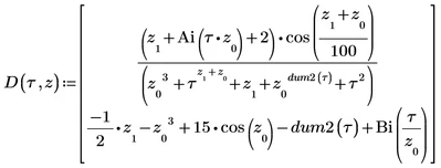

Hi, Many thanks for the references - they helped steer me in the right direction. I tried to break sbval using a really tricky D matrix (no idea what it represents)  using:
Remarkably, sbval found the initial conditions to satisfy boundary conditions - see attached terse worksheet. By playing with additional changes I could switch between - "cannot converge" and my original error message - but it was not clear what was causing the switch. But everyone's help showed me that I was at least using sbval correctly and that the problem resided in my D  matrix somewhere. I finally got sbval working by non-dimensionalizing the differential equations - which may have cleared up an incipient fault with units that I could not see.
Many thanks for the rapid response from everyone!
