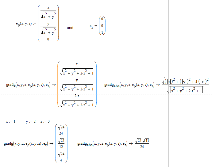

I'm setting up a worksheet to enable me to check my workings for when I need to solve a two or three dimensional scalar field by hand (cylindrical & spherical polar coordinates).
Mathcad partially differentiate some but not all and it flags some variable. Also, I cannot get grad f or |grad f|.
I'm obviously setting up something incorrectly.
Could someone point me in the right direction, please?
I'm enclosing my worksheet.

Thank you Alan for the corrected worksheet
Question: I've noticed that MathC does not return a scalar for | grad f | . Should it not return a scalar value instead of a vectorial value, as I'm not working out | grad f | in the direction of its unit vector grad f / | grad f | ?

It does return a scalar value. However, to see this more clearly it's probably best to define ep as a function and then insert specific values when it is called. For example:
(Actually, ep need only be defined as a function of x and y. I've included z above, but it's superfluous).
